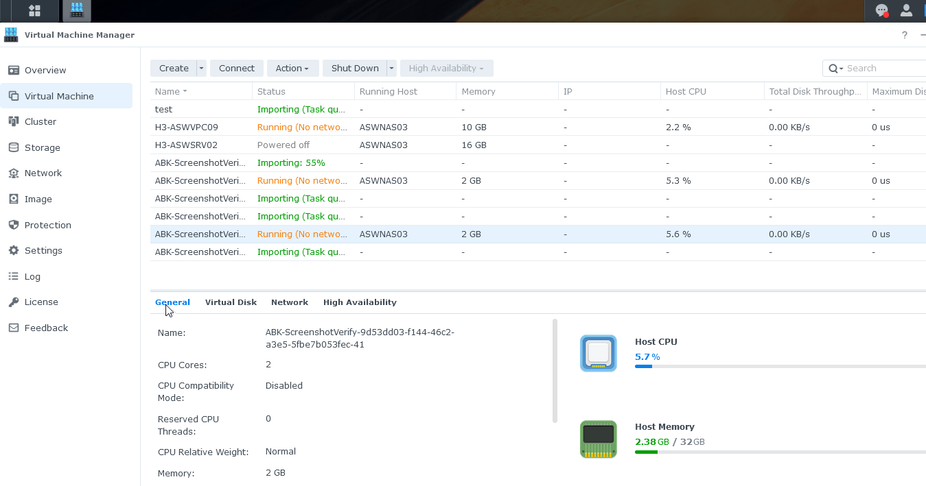

We use Synology NAS majorly for backups with ABB.
The backup plattforms are usually maxed out to official limit with RAM as we verifiy each backup through the VMM startup verification tool. EXTREMLY NICE FEATURE to check if your backups are actually working
DS1522+ is an excellent plattform for mid-seized companies but due to a single 10GB slot it can only be used for HA clusters with 1GB
The brand new DS1823xs+ is our new go-to plattform for HA clusters as we can use the built-in 10GB for network access and a 10GB NIC on the PCI slot for the heart beat connectivity. So far we had not issues with differemt cpu types (XEON on server, RYZEN on nas) when restoring the VMs
