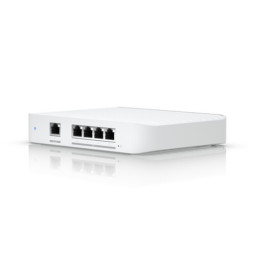

So in this case you have two options:
  1. Use the tutorial from my first comment for just the 10 gig PC, (this is the cheapest)
  2. Buy a 10 gig switch. Probably the best one right now (for the price) is this:
