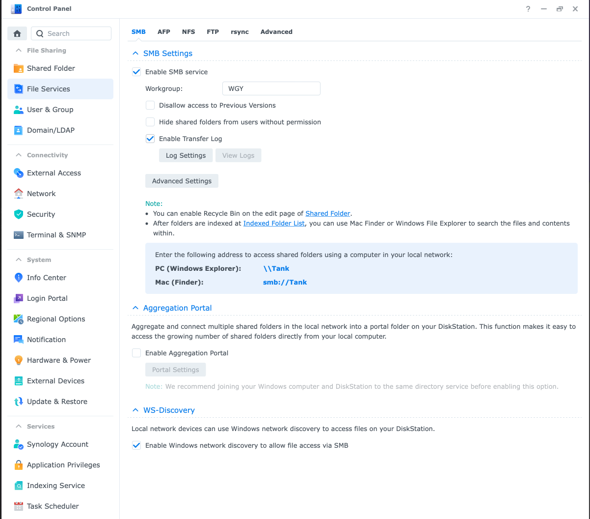

I keep having issues that when I need to use a file it is missing. When I go to the recyle bin it is in there.
How do I find out how it was put there and who deleted it?
What you want to do is go into SMB settings and enable Enable Transfer Log
You will then be able to view the logs to see when the file was deleted and by who
