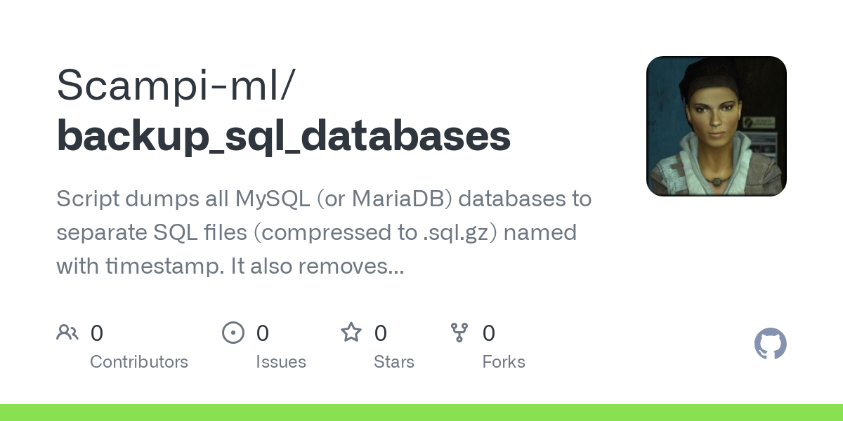

Sorry for grave digging, but i use this
Script dumps all MySQL (or MariaDB) databases to separate SQL files (compressed to .sql.gz) named with timestamp. It also removes old backups (older than specified amount of days).
It works perfectly fine on DSM
