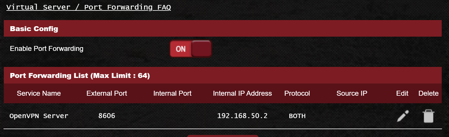

I suspect it is a “port forwarding” setup issue. When I used PortCheckTool.com, it prompted time out.

My Router is Asus GT-AX11000.
Maybe you need to define the internal port as well in your router to enable port forwarding.
Depends on router. For many the internal port is automatched to the external port when unspecified. You can see from the VPN settings that this user’s internal port matches the forwarded port.

As indicated, something not setup correctly on port forwarding. Any idea / advice how to resolve this?
Are you able to reach anything, that requires port forwarding, from outside your LAN? If not, maybe you have a CGNAT WAN IP. You must rule that out!

Also, maybe you’re timing out because you don’t have a firewall rule opening the port to the outside on your router. You need to make sure all ports forwarded on the router and NAS have complimentary firewall rules on the router and NAS. I run VPN servers on two of my four diskstations.
