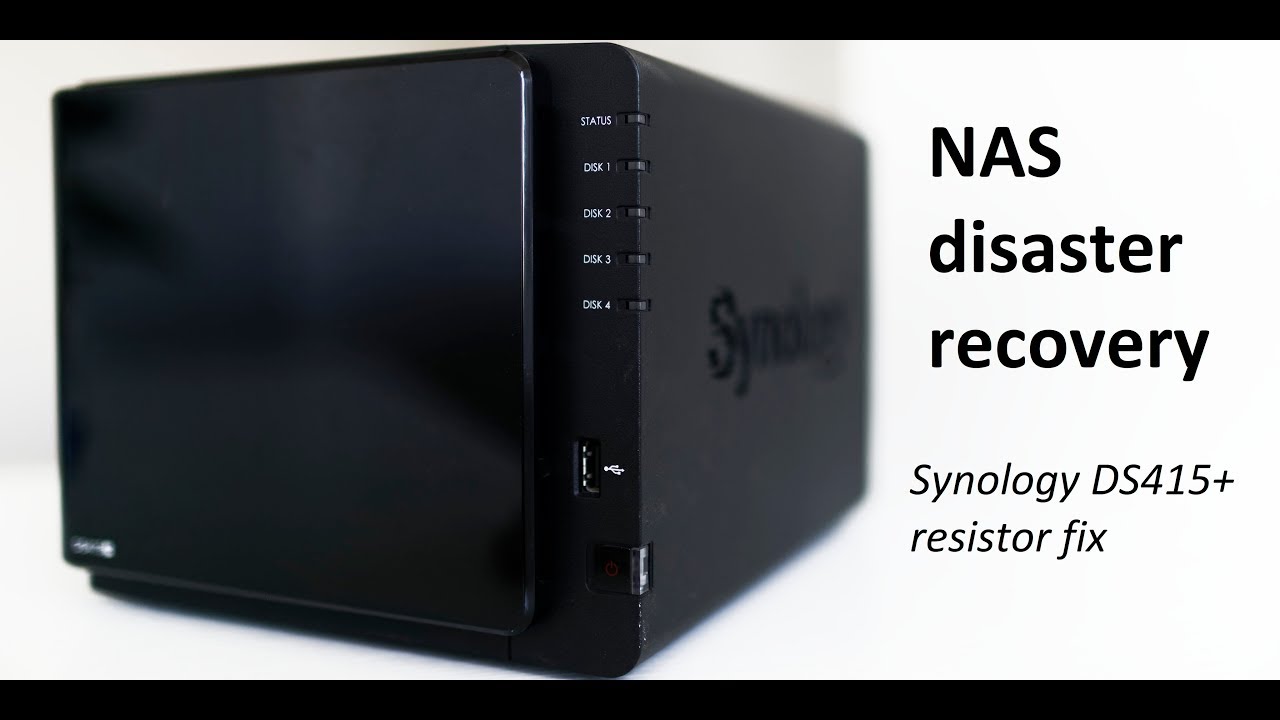

The blink blue light on Intel systems can often be fixed with placing a resistor on the motherboard.
I think i fixed DS415 and DS418 but it been a while and i might confuse the DS418 with DS420. Amywaxs, before discarding the unit you might give it a try.
https://us.rs-online.com/product/rs-pro/7397370/70650936/
You can find more information looking in the synology forum with key words “100ohm blinking blue”
