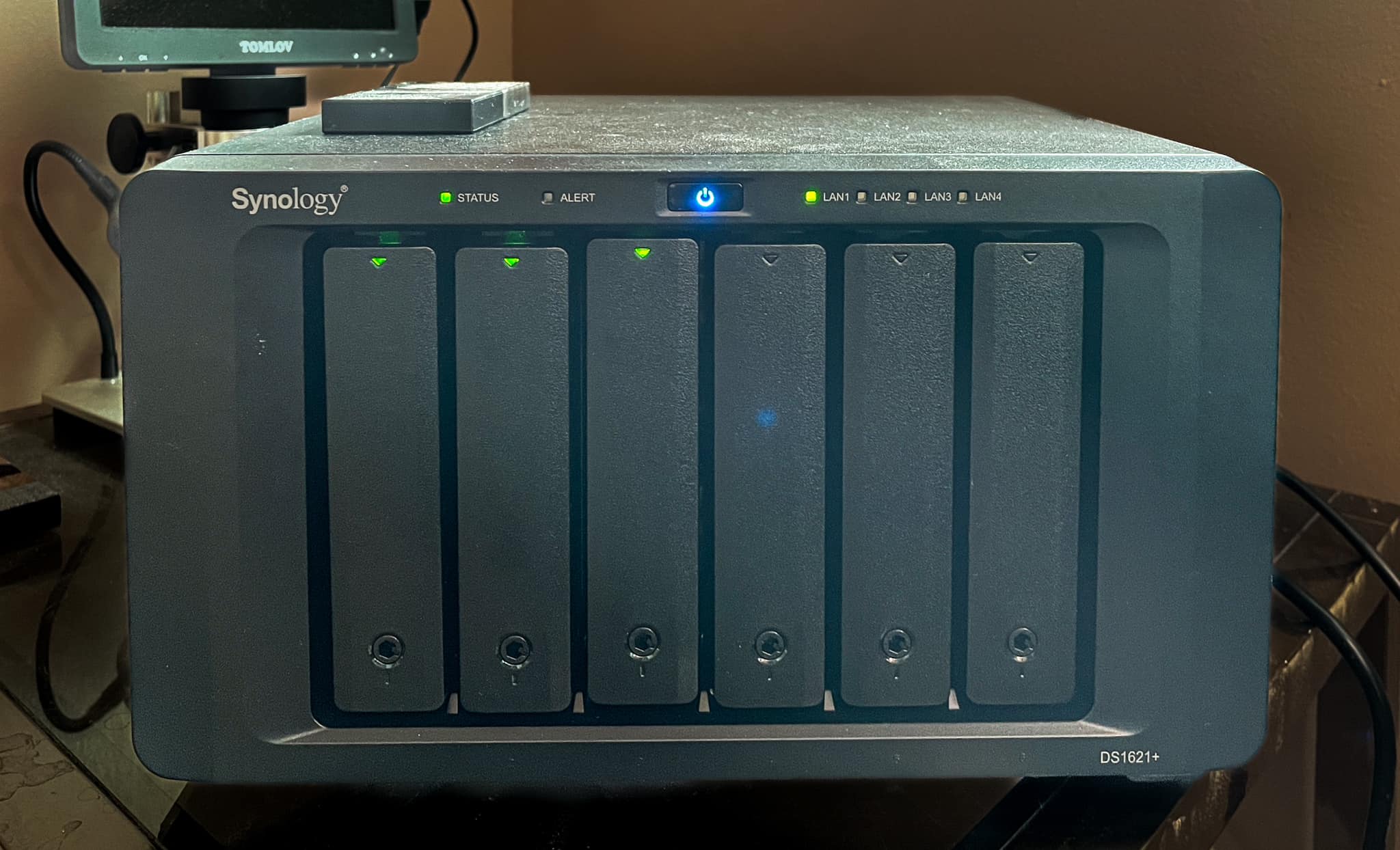

Planning my NAS migration from DS223 to DS1621+
Pulled the plug on the bigger NAS (DS1621+). I could see the DS223 was not going to suffice over the long haul for my image and video editing and backup. With the DS1621+, I also ordered one more 12TB Seagate Ironwolf, and 2- 1TB M.2 2280 PCIe (4.0 x4) NVMe Solid State Drives for the SSD Cache. My current plan is…
  1. Power off DS223 and let drives spin down.
  2. Move the 2-12TB drives from the DS223 over to the DS1621+.
  3. Power up the new NAS and go through the migration for the two drives.
  4. Power down new NAS, remove the drives, and install the 2-SSD’s in the cache slots.
  5. Power up and complete the cache setup.
  6. Power off the NAS and install the new 12TB drive (for a total of 3 active drives)
  7. Power on the NAS and configure the new additional drive.
Would imagine you could go in either order - install SSD for cache, then the new 12TB drive, or vise versa?
How does the plan sound? Any flaws in the logic I need to correct?
The current drive setup in the DS223 is the SHR RAID config. Once I get everything moved to the DS1621+, and install the additional 12TB drive, do I want to continue that kind of RAID? Or, do I want to change it to a different configuration? Is that even possible without loosing data?

So far so good. Both 12TB drives moved over to the “new” DS1621+ from the “old” DS223. Two 1TB SSD’s installed and setup as cache. Numerous setup/config items completed. Today I hot installed a new 12TB drive and am now letting the RAID incorporate it into the pool (looks like an all weekend thing).
I was pleasantly surprise (understatement!) that the DS1621+ so readily incorporated my two data drives and seemingly embraced the various data structures I had on them. When I opened up Lightroom and it read from the NAS it was like just before. And the previews snapped into place very nicely. I was also able to launch a Final Cut library directly from the NAS via Finder, and the video timeline was very snappy.
Praying now for a successful pool update.:slight_smile:
Whew! :grin: :tada: :zap: :boom:
