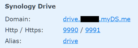

I am using a Synology ddns domain name, have a reverse proxy on the Synology, and the appropriate ports forwarded on my router. I configured a custom port for Synology Drive in Control Panel > Login Portal > Applications, for both https and http. I also configured an alias and a customized domain:

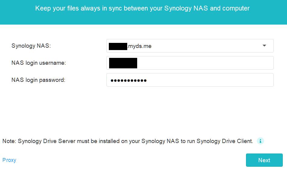

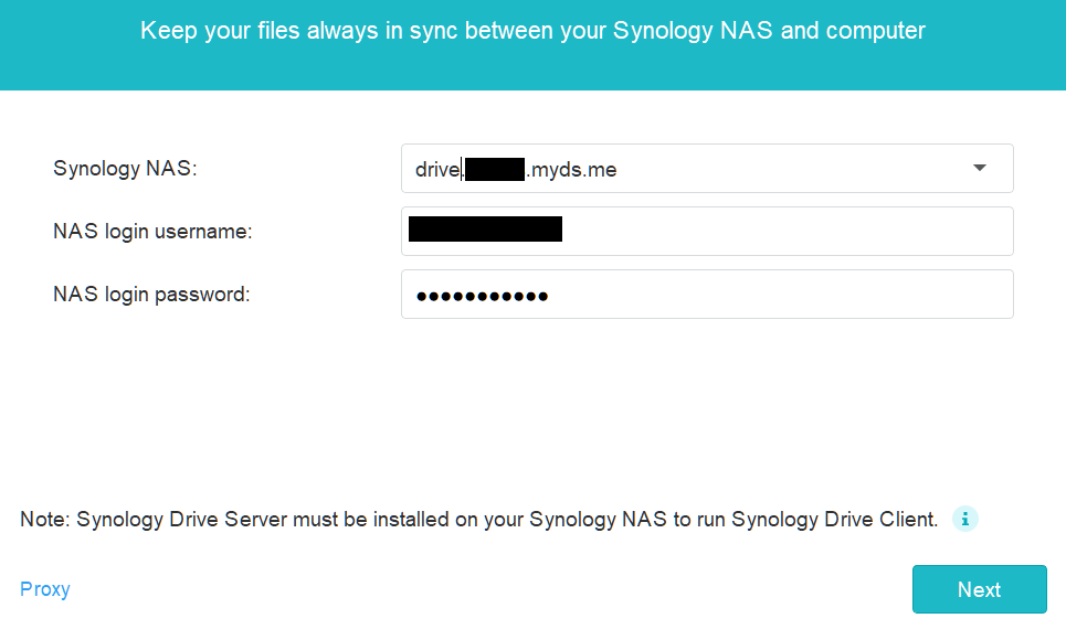

I then try to connect using the Synology drive client on my windows PC. I tried both with and without the ‘drive’ prefix shown above:

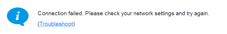

I get a connection error every time:

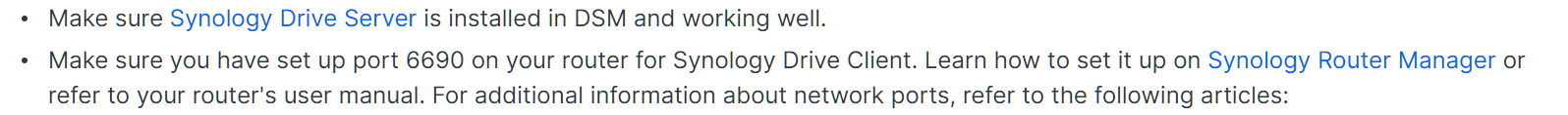

I mentioned the drive server because at the bottom of the login screen of the client it does say you need the Synology drive server installed on the NAS. AIso, when I click on the “troubleshoot” link on the error message I see this:
So I sort of assumed I needed the Drive server and that it only works if I forward port 6690 on my router? What am I missing?
