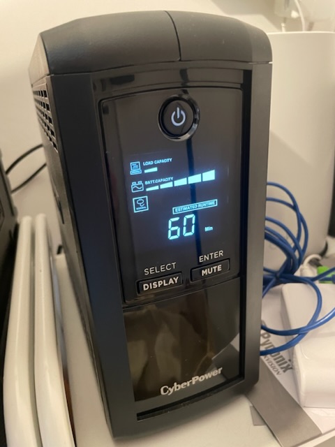

Does your UPS menu show 100% battery charge and a reasonable “run time” given the power draw from all the attached devices? My first guess is your battery is failing or the UPS is overloaded. How many devices aside from the 4180 Play are attached to your UPS? I’m sure you know not to attach a power strip to the UPS to gain more outlets. Also, have you tried pressing the red reset button on the back of the UPS?

Everything looks normal on the UPS (image attached).

so we can rule out a communication issue because the UPS is telling the NAS that the power is out.
If I had to guess either the unit is self testing, or more likely you have some junk power that is meeting the threshold for the UPS to start going on battery

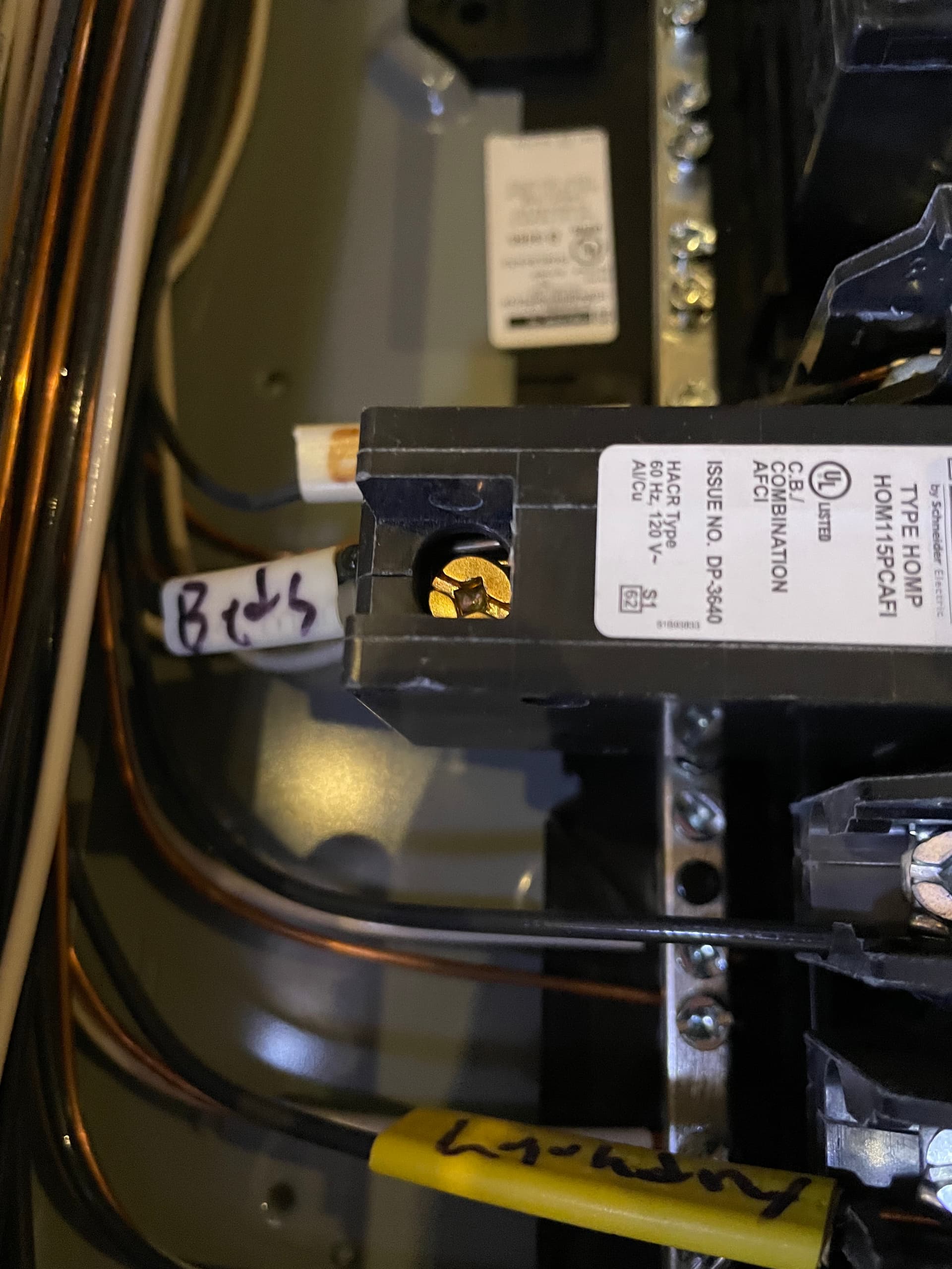

So here is a weird one. I had pretty much the same thing happening after setting up in a new home. Turns out when the electrician landed the lead in the breaker panel, he missed putting the wire under the lug. It was just laying on top the breaker terminal when he torqued the lug. The wire was arcing building up carbon and getting hotter and hotter. If it wasn’t for my ups complaining, it could have burned my house down. Lets hear it for homelabs! The wire doesn’t have to be laying on top for this to happen, just being loose can do it to.
If you look close you can see the lead above the breaker lug and the wire insulation starting to melt.

Thats insane! I never would think to check for that! Great info!
-Will
