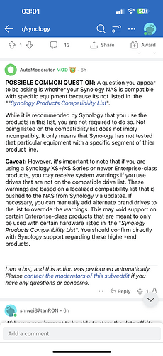

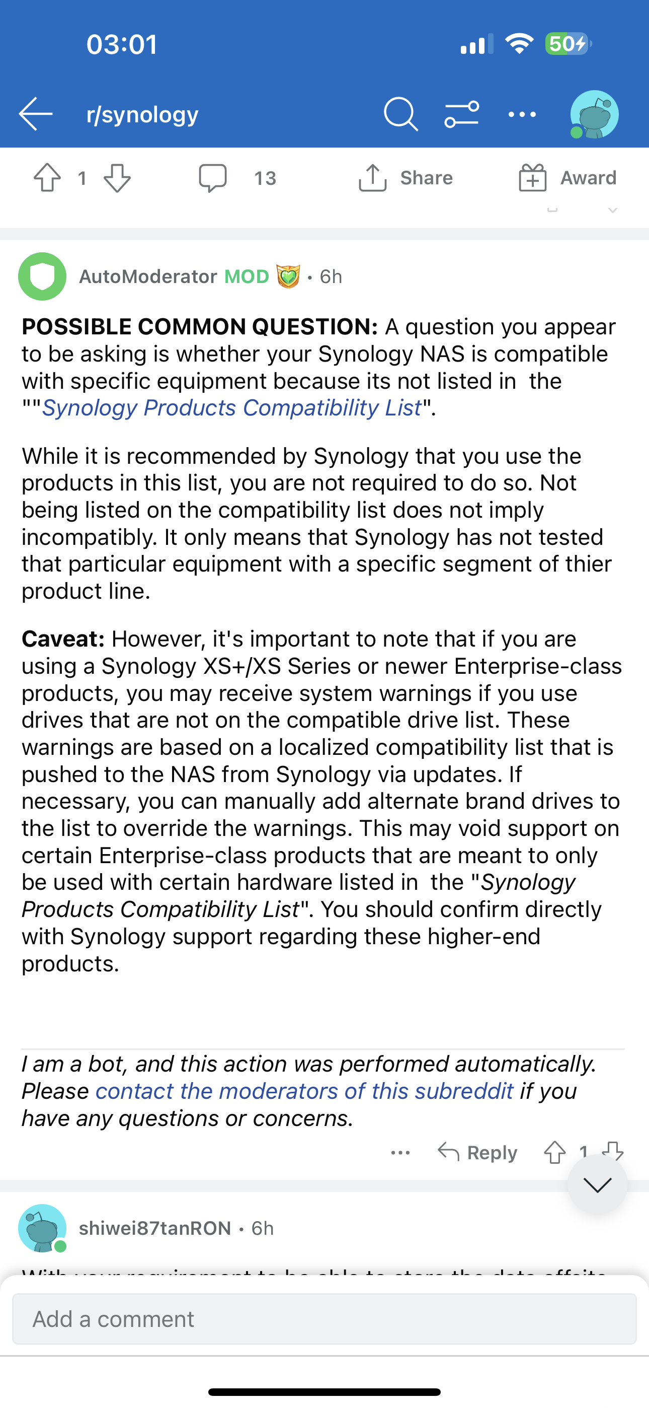

I think this automod from synology reddit answers your query.
Yes you can, it will only give a quick warning when you first build the volume, but thats it
